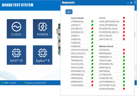

I received a new module from the distributor.
However, after powering it on and running the diagnostic test (board_test_system), I’m still getting a message that two devices are not responding—see the picture below.
