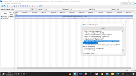

6 years agoproblam with modelsim
the program supposed to count the number of '1' in a given 32bit input library IEEE; use IEEE.std_logic_1164.all; entity one_cnt is port( serial_bit_input : in std_logic_vector (31 downto 0); r...

6 years agoHi Matan,
From what I see, you are using different package other that std logic between component and entity declaration result in mismatch type. Try to change you code in your testbench in component port same to std logic package
entity one_cnt is
result : out integer range 0 to 32) ;
Refer to link below as it same case with you for reference
https://forums.intel.com/s/question/0D50P00003yyQfgSAE/modelsim-types-do-not-match?language=en_US
