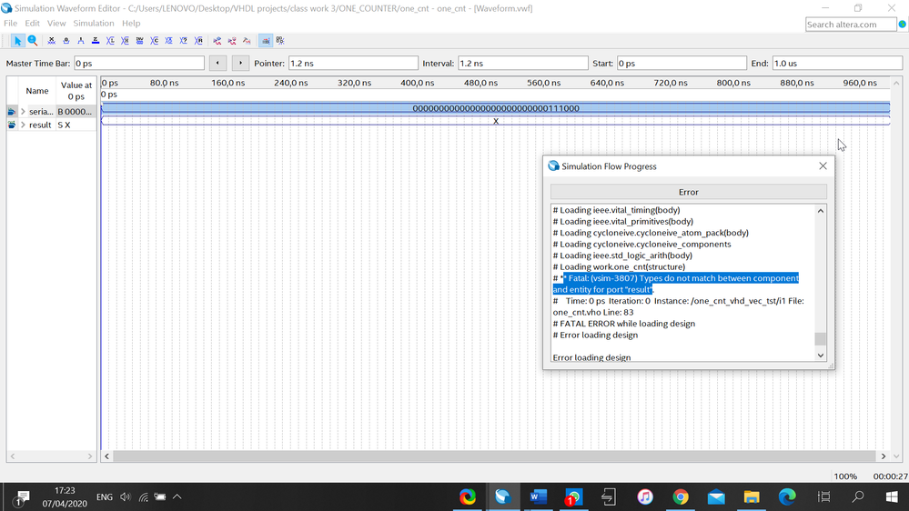

problam with modelsim
the program supposed to count the number of '1' in a given 32bit input

as you can see :
* Fatal: (vsim-3807) Types do not match between component and entity for port "result"
what sould i do?

Hi Matan,
From what I see, you are using different package other that std logic between component and entity declaration result in mismatch type. Try to change you code in your testbench in component port same to std logic package
entity one_cnt is
port( serial_bit_input : in std_logic_vector (31 downto 0);
result : out integer range 0 to 32) ;
Refer to link below as it same case with you for reference
https://forums.intel.com/s/question/0D50P00003yyQfgSAE/modelsim-types-do-not-match?language=en_US
