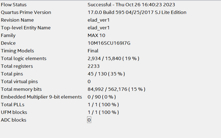

Hello, I tried to follow the process of Early Power Estimators (EPE) for power analysis, but it shows no memory left. Best Regards, Shweta Sawant
- 2 years ago
Also, all the bank in the given FPGA re 3.3V but here it shows 3V for 2 banks. Is there any chance that we can change it?
Shweta_sawant
2 years agoI am geeting error of low: user Provided insufficient toggle rate. What should I do??? any refrence documents. It's on priority
- sstrell2 years ago
So that’s the power analyzer, not the EPE. The low confidence metric is because you haven’t provided enough information to get an accurate analysis including signal toggle rates. See this training: https://cdrdv2.intel.com/v1/dl/getContent/653116
