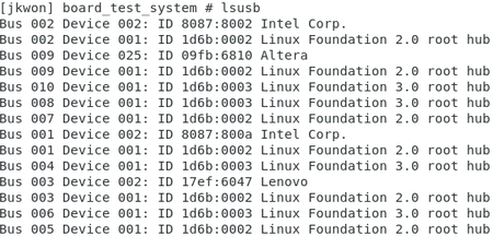

Hello. On-board blaster not detected. My FPGA board is Stratix 10 MX FPGA Development Kit, and OS is CentOS 7. The board and the PC are directly connected to each other through Micro USB Cable. ...

Hello YL,
Thank you for your reply.
I installed Quartus v18.0.1. I can execute the BTS.
But I can't configure fpga design.
I executed "configure with *** Design" in Board Test System.
However, the BTS has not changed.
I attach the teminal log file(log.txt) and screenshots.
