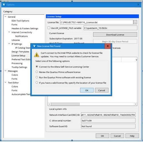

I've purchased a nios license about a year and a half ago
About a month ago I've tried to transfer the license to another computer
after generating the licensee from the intel web site and uploaded the dat file I got this massage below
does anybody familiar with this problem?

Kindly provide the screenshot of License Setup as well.

- The Lite edition software does not require license. You may click cancel.
- Do you see the NIOS II IP license in the license setup? Can you provide a screenshot?

It seems to be OK I choose cancel instead of OK and now I can compile my code and produce a SOF FILE Thank you
