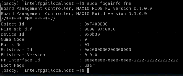

Hi, I am setting up an Arria 10 N3000 PAC, and when I ran `sudo fpgainfo fme`, it shows the output as below. My MAX10 version is way too low, and is the Bitstream version: 0.00 and value for Pr Interface Id expected?
I am running on CentOS 7.9 with Intel Xeon CPU.
You need install the latest stack, and perform One Time Secure Update.

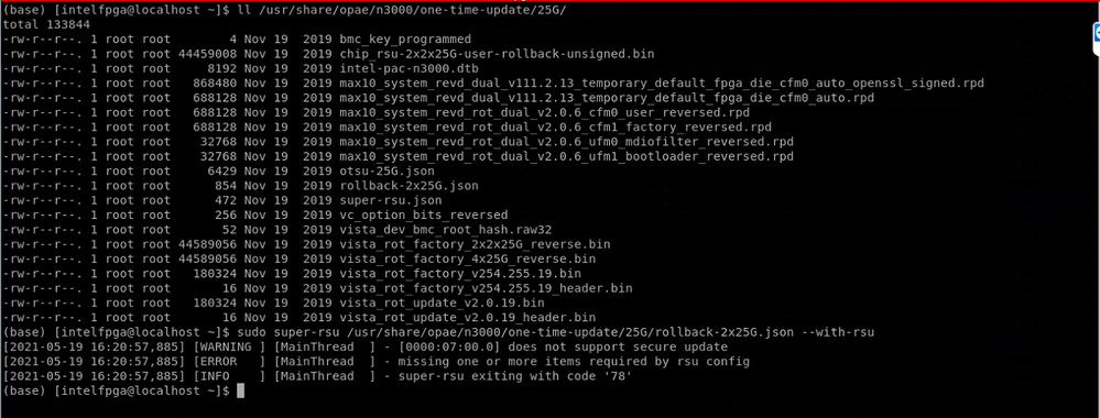

I ran into this error when performing the One Time Secure Update.

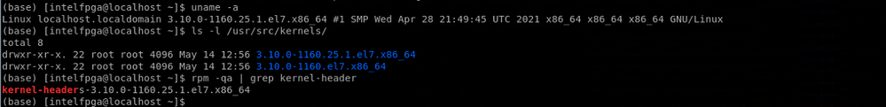

Some information on the Linux.
Thank you.
