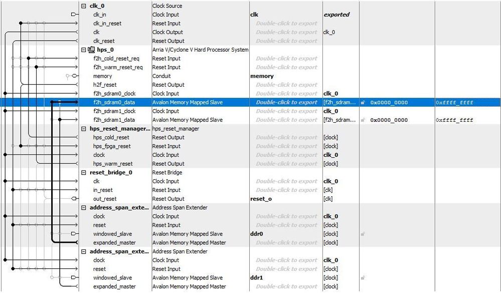

I am trying to read and write to DDR3 in DE10 nano with multiple Avalon MM interface . While using single Avalon MM interface ,it will work. But using two MM interface one port waitrequest is always high.

Yes , Avalon MM and AXI interface have problem in wait-request signal for port 1. We can continue the conversation in previous thread
