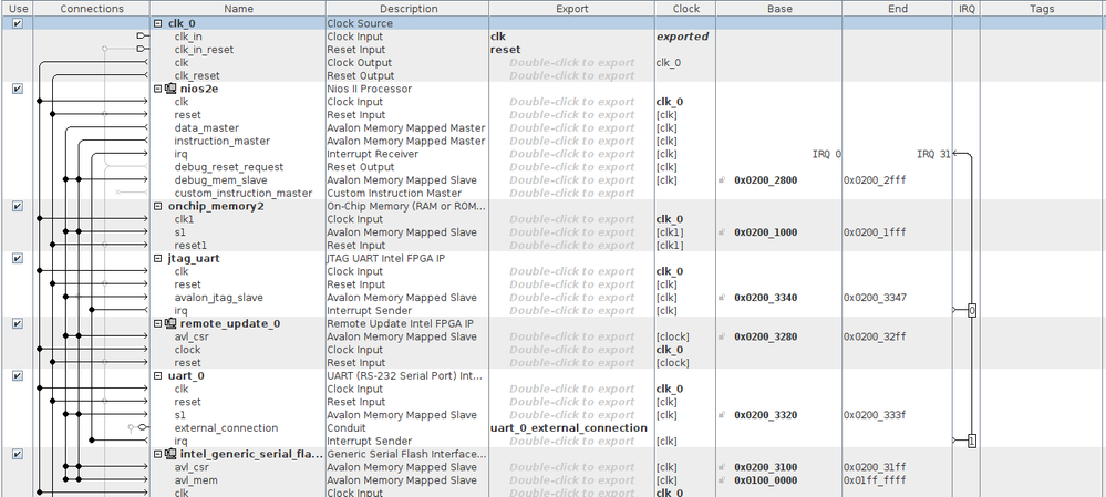

Hi fellows,
I am creating a FPGA project for the Cyclone 10 LP evaluation board.
The project is setup like shown below. I would like to write to the external flash with the NIOS2 softcore.

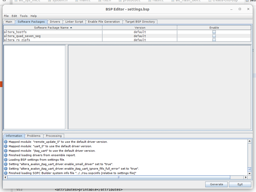

You see - no rocket science here. My problem now is that I cannot enable the altera_safeclib in the BSP editor, because it is not available (see picture below). However, this is required according to https://www.intel.com/content/www/us/en/docs/programmable/683419/22-1-20-1-1/nios-ii-hal-driver.html.
Any help is appreciated
Are any examples around, where the NIOS2 writes to the external flash by utilizing the Intel Generic Serial flash?
Greets

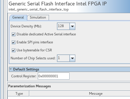

  • Here is the settings for the GSFI IP.
    Hope it helps.
    Thank you.
    Kelly Jialin, GOH
  • KellyJialin_Goh's avatar
    KellyJialin_Goh
    The GSFI IP needs to be enabled with the following settings (refer to picture below. Next, regenerate the .sopcinfo file and you should be able to see the altera_safeclib.
    If you are still unable to see the altera.safeclib, it might be due to the software is not updated to the latest version.
    KellyJialin_Goh
    Hope it helps.
    Thank you.
    Kelly Jialin, GOH
  • Joda's avatar
    Joda
    thank you. considering the settings and the regeneration of the .sopcinfo solved my problem
