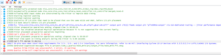

Hi, I was told that the memory size in Cyclone 10 LP 10CL120YF484 is 540KB in this link:https://community.intel.com/t5/Nios-V-II-Embedded-Design-Suite/Configure-NIOS-firmware-burning-interface/td-p/...
