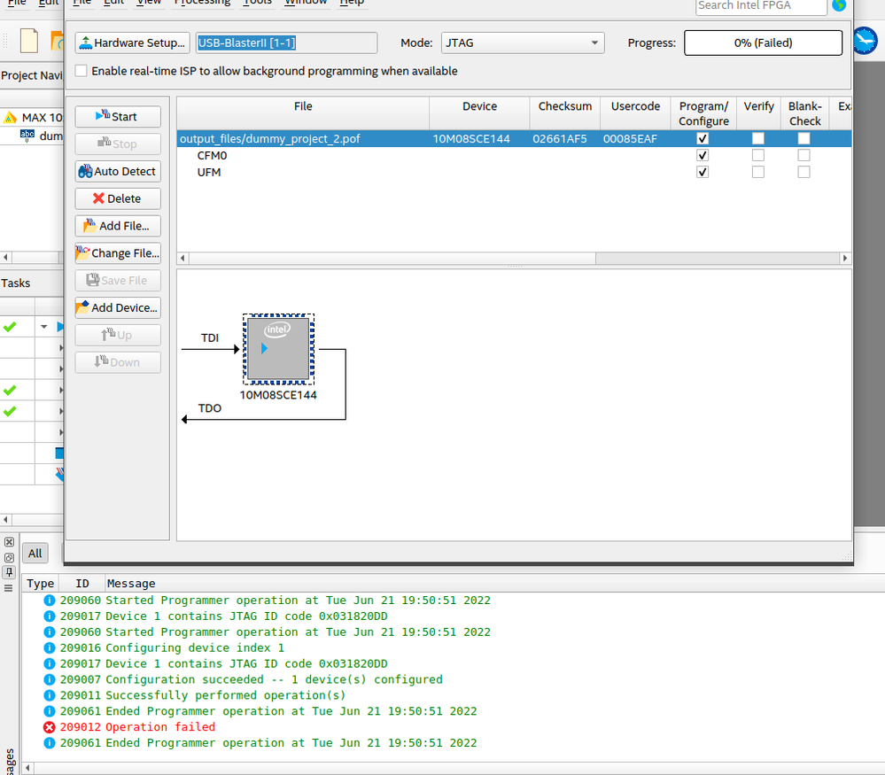

MAX 10 Configuration Flash Memory (CFM) how to write to it?

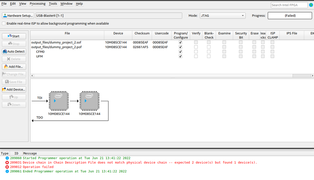

I have a 10M08SCE144I7G device connected via JTAG using the Altera USB-Blaster II and Quartus Prime 21.1 Lite Edition. I want to program the configuration flash memory but I get this error:
Error (209031): Device chain in Chain Description File does not match physical device chain -- expected 2 device(s) but found 1 device(s).
as seen in the following screenshot:
If I click in the "Auto Detect" button it only detects one thing.
This is a new FPGA for me, before I was using a 10M04SCE144C8G mounted exactly in the same board that I am using now (the FPGA was replaced). For that old FPGA, if I am not mistaken, I was able to program the CFM in this way.
How should I proceed to write my program in the CFM?
