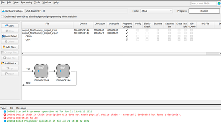

I have a 10M08SCE144I7G device connected via JTAG using the Altera USB-Blaster II and Quartus Prime 21.1 Lite Edition. I want to program the configuration flash memory but I get this error:
``` Er...

4 years agoNo. I start Quartus, open the programmer, click "Auto detect" and only one device appears which is associated to the `.sof` file. If I now click "Start" it programs and I get the green "Success" light in the top right.
With my old FPGA I was somehow able to program also the `.pof` and I want to do this now on this one. So now I click on "Add file" and select the `.pof` file. This creates the drawing of the second device, which looks the same as with my old FPGA. But now it fails to program.
I do want to program the two of them.
