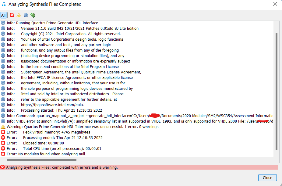

I am trying to implement a HPS-FPGA design using DE1-SoC. However when I try to add my VHDL code to platform design, after "analyse synthesis files" I get an error about peak virtual memory. I tried to google this but cannot much find useful information about this. I uploaded a screenshot of the error shown.
I also attached my VHDL file. It has been tested many times in Questasim and works as expected, but now is the time for synthesis.
Minor question: I used process(all) in my VHDL design, this only works in VHDL 2008. Since a sensitivity list in a process is ignored while synthesis I am assuming this would not be a problem?

This error is fixed by changing the sensitivity of the process(all) to including signals. The sensitivity list in VHDL only supports "all" in VHDL 2008 which is not available in Quartus Prime Lite.
