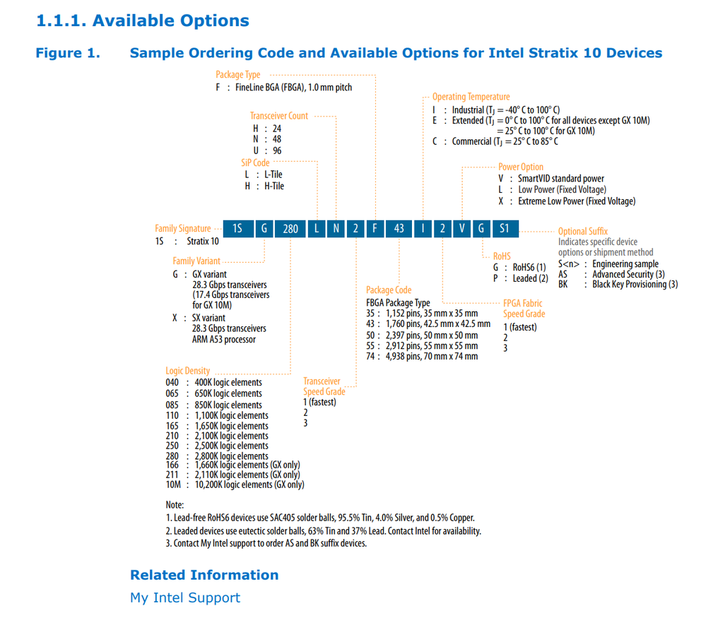

  • It seems AS and BK are different features and won't exist in same devices.
    Refer to the following figure, which can be found in Overview, AS and BK can be known from Ordering Code.
    Take Intel® Stratix® 10 GX 2800 FPGA for example, 'AS' and 'BK' are listed in different Ordering Code, which means they appear in different devices.

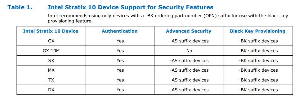

      AS and BK are two of the options for the Stratix 10 package as defined in the user's guide.
      AS : Advanced Security
      BK : Black Key Provisioning
      Does the Black Key Provisioning come with the rest of the Advanced Security features?
  • armc02's avatar
    armc02

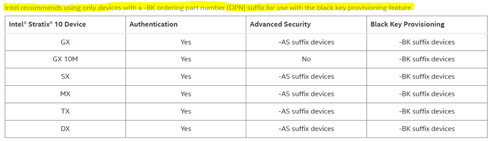

    This document shows Advanced Security (AS) and Black Key Provisioning (BK) as two separate options. If I buy a Stratix 10 FPGA with the -AS option, I assume that it will not include the -BK features. I want to know if I buy a Stratix 10 with the -BK option will it include the -AS feature, or are the two mutually exclusive? This answer is not stated in the provided link. Thank you.
  • Mengzhe's avatar
    Mengzhe
    It depends on FPGA series.
    This chart shows that Stratix 10 GX 10M will not include AS feature, while others will include AS.
    • armc02's avatar
      armc02
      My question is if I buy the BK option is the AS included. The chart shows AS suffix devices and BK suffix devices. Nowhere does it say that if I buy the BK suffix device that it will include the AS suffix device features. The way it is written leads me to believe you get one option or the other, not both. Am I losing out on the advanced security features if I buy the BK opn?
      • Kiranraj's avatar
        Kiranraj
        No, -BK suffix OPN includes all the features of -AS suffix OPN and adds on the Black Key Provisioning feature.
  • Mengzhe's avatar
    Mengzhe
