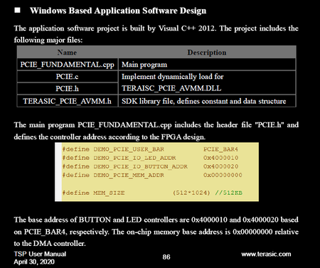

1 year agoInsufficient PCIe reference design on Cyclone V GT 5CGTFD9D5 OpenVINO
Hi, I have a little bit of experience with FPGAs and VHDL coding, but this is my first time dealing with PCIe. I have a Cyclone V GT 5CGTFD9D5F27C7N OpenVINO PCIe card devboard that I intend to us...
