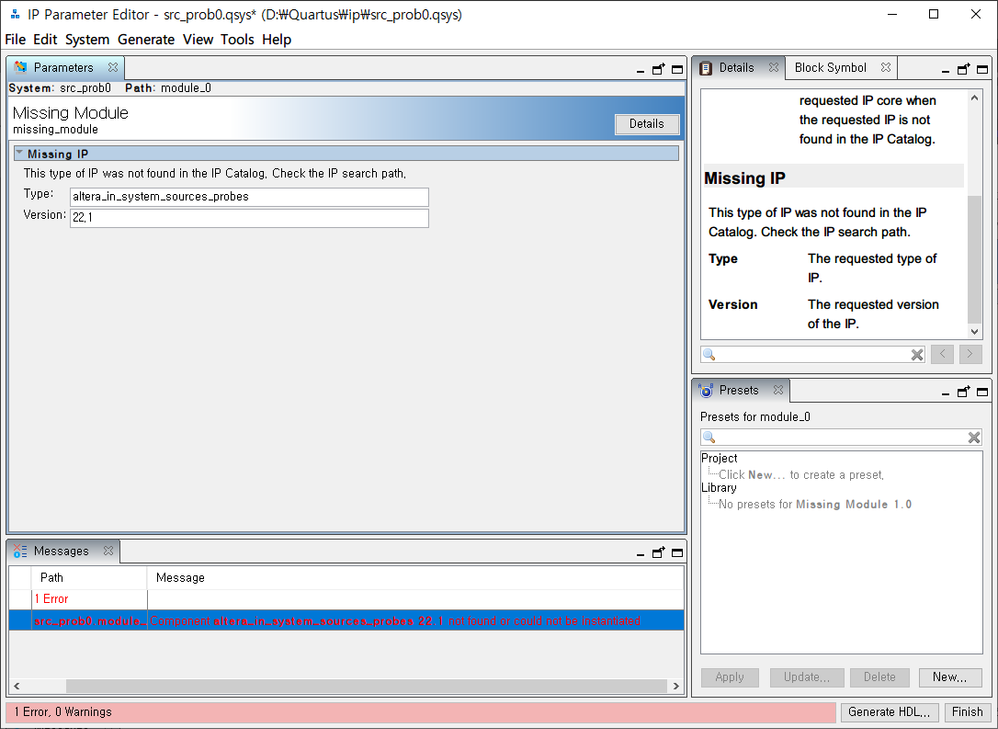

2) In addition, I'm having trouble using the built-in clock. I've been trying to follow along with other YouTube tutorials, but when I go to the IP Altera-In-System Sources & Probes window, I get an error: 'Component altera_in_system_sources_probes 22.1 not found or could not be instantiated.'
If you know how to resolve this error or where I can download the corresponding file separately, please let me know. I'm currently using Quartus Prime Lite.

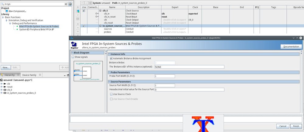

    For Question 2: Try to replace with a new In-System Sources & Probes IP (ISSP) in platform designer (QSYS) check screenshot below.
    Sheng

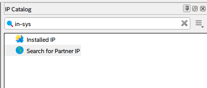

      • sstrell's avatar
        sstrell
        You're looking in the Quartus IP Catalog, not the Platform Designer IP Catalog, though it should be available in both. Bad installation of Quartus perhaps?
