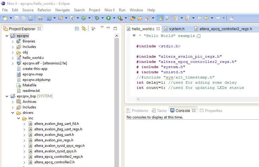

Hi @ABola2 ,
First check if you have altera_avalon_pio_regs.h & altera_avalon_uart_regs.h files in design directory "<Project>_bsp->drivers->inc" folder. If yes, Clean the project and build the project. If no, You have to add appropriate headers which are available.
Refer the image attached.

Hi @ABola2 ,

Hi @ABola2 ,
You can recreate the project if you have .sopcinfo file & add your .c source file to project and check.
Attach error message.
Which example design are you using? Can you share it?
Anand
