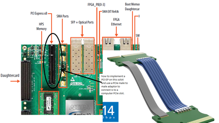

implement PCIe on Arria 10 EVM board
- 5 years ago
The concern here is the direction of the PCIe refclk and also the PERST. When you used it as EP, both of them are input ports. For the RP (default), both of them are output ports. It is suggested to use the Arria10 development kits for the PCIe Endpoint application if possible.

Thank you very much, I need some time to digest your reply, I accept it as solution, I may get back to this topic if I have more question, appreciate your help.
