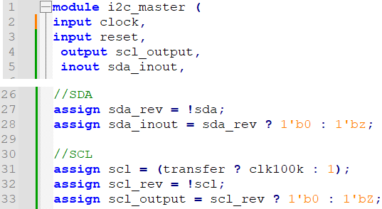

SDA and SCL signals
Since I2C signals are connected externally to pull-up resistors I have two signals (sda and scl) with the value I want the I2C bus to have. And then I have two wires with the inverted/reverse value (sda_rev and scl_rev). These signals are the output enables of tri-state buffers:
Actually scl is not bi-directional, but I apply the same concept: the line is always in high impedance (pulled up externally) or pulled low by the i2c_master.

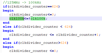

Frequency of SCL
The slave device can work with 100 kHz or 400kHz. I use 100kHz just because it allows for integer division with 125MHz (8ns).
100kHz has 10000ns clock cycle: 5000ns up/down: (8ns*625)
I simply change the polarity of the new clock every 625 clock cycles.
