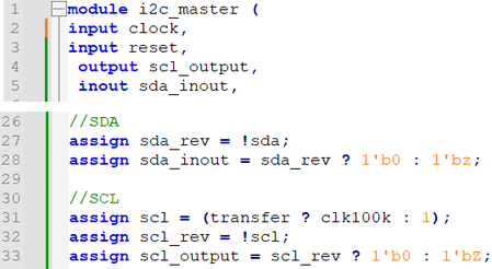

The problem is solved.
The I2C slave device does not allow a read like I was doing. First there should be a write before the read. It has a specific pattern for each operation, concerning if it's a read or write and concerning the register that is accessed.
These details are explained in the datasheet of the I2C external device (TI TCA9534PWR): https://www.ti.com/lit/gpn/tca9534
