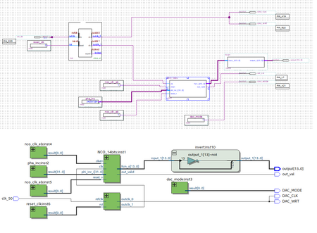

I have trouble with demo THDB-ADA board
As I understand it, you have some inquiries related to using NCO in CV device to generate 10MHz sine wave. You are interface the CV devkit with Terasic THDB-ADA daughter card. You seems to mention about Altera demo. Just would like to check with you if you are using any example design?
To facilitate further debugging, would you mind to do the following:
1. Just wonder if you have had a chance to perform Modelsim simulation with you CV NCO design to see if the NCO output is expected? This will be helpful to isolate functional issue prior to hardware testing.
2. If there is no issue with the Modelsim simulation, you may proceed to hardware and then use signaltap to verify the NCO output.
3. If the above #1 and #2 have no issue, you might need to further look into the daughter card to cross check the user guide to see if you can spot any anomaly.
Please let me know if there is any concern. Thank you.
Chee Pin
thank you so much for replying my question. I have solved this problem. I intended to use just channel A of the DAC on the daughter card but it requires clock on both channel A and B. When I used a same clock for channel A and B, it worked and generated 2 sinwave exaclly the same at the output.
