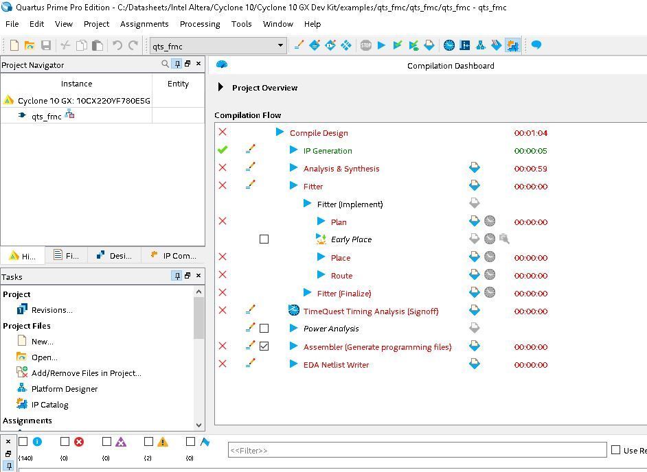

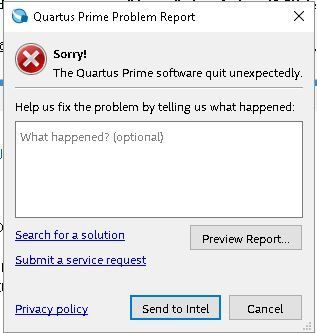

I am on Windows 10 with Quartus 17.1 and do not seem to get a valid compile for a Cyclone 10 GX device, Quartus crashes and quit. I am new to this forum and Quartus, please any help or advice would be appreciated.

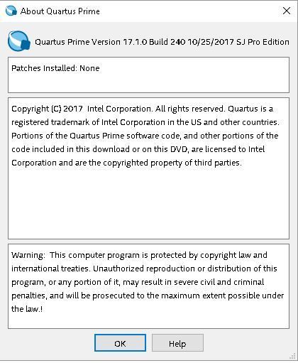

  • Hi Jaco, Good day to you. Kindly provide more information as below. 1. Which Quartus Prime Edition you're using? 2. Print screen of the following error. Thank you.
    • JMart98's avatar
      JMart98
      Hi Calvin
      Thank you for the response, please find attached the info you need.

    Problem Details
    Error:
    Internal Error: Sub-system: FIO, File: /quartus/ccl/fio/fio_path.cpp, Line: 85
    Path name is too long -- must be shorter than 260 characters
    Path (length 286): C:/Datasheets/Intel Altera/Cyclone 10/Cyclone 10 GX Dev Kit/examples/qts_fmc/qts_fmc/ip/xcvr_test_system/xcvr_test_system_data_pattern_generator_0/altera_avalon_data_pattern_generator_171/synth/xcvr_test_system_data_pattern_generator_0_altera_avalon_data_pattern_generator_171_7y4u42a.v

    Quartus Prime Information
    Address bits: 64
    Version: 17.1.0
    Build: 240
    Edition: Pro Edition
  • sstrell's avatar
    sstrell
    As the error states, your path is too long and you have spaces in it. Try shortening the path (put the project folder closer to the top-level of your hard drive) and avoiding spaces.
