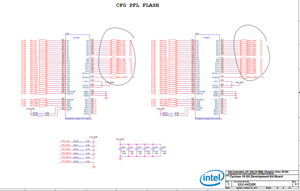

- NikoR
There are two MT28EW01GABA1LPC in parallel making a total of 2Gb with 32bit wide databus.
