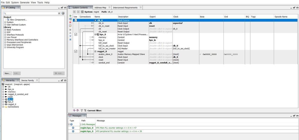

​Hi, I have made the following qsys system as shown in fig. I have assigned the outputs to the LEDS. So whatever number I sent via putty terminal, the corresponding LEDS are light up on the board. The header file I generate with generate script gives me the base address and offset address of the LEDS. Now, I don't want to use any hardware peripheral on board, I just want that whatever value I send to the register, the value saved in the register is simply shown at the putty terminal. I am just confused that I have used LEDs in my pin assignment editor of my Quartus software so that's why a header file is generated that tells me the base and offset addresses but how do I get base and offset address of my output terminal with out because these are the addresses that I am using to tell my c code that give me output at this address and write at this address.

  • FawazJ_Altera's avatar
    FawazJ_Altera
    I am a bit confused regarding your request.
    HWLIB is not supported to run on linux.
    You are trying to send a value to HPS via putty, this value will be stored in a register, I assume this register is routed to LEDs through pin planner.
    If you write any value to this register, you need to see some LED blinks, am I right?
    usually we use GPIO to control LEDs. It is simpler.
    is this regget custom component?
    • matif's avatar
      matif
      I am running quartus software in windows so my host computer is running on windows 10.
      Yes regget is a custom component.
      I solved the problem. So, I was trying to print ascii values using %c in my printf(), that was the reason that I was not able to get output. I used %d and now I am getting correct outputs.
      Yes you are right we usually use GPIO for LEDS that is much simpler but I didn't wanted to use LEDS. So the concept is that you connect your register to AVALON MM bus so whatever you want to read and write on AVALON MM, you just write on it using virtual memory mapping and that will be printed on output of putty.
