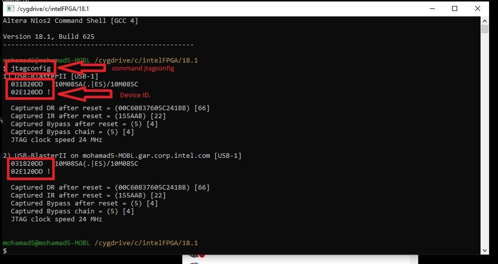

    Can you check your JTAG connection first whether it is working or not? (jtagconfig)
    open Command Prompt ---> go to Quartus directory <Quartus installation directory>intelFPGA\18.1\quartus\bin64> ---> run jtagconfig
    And, show me the screenshot of your jtagconfig ?

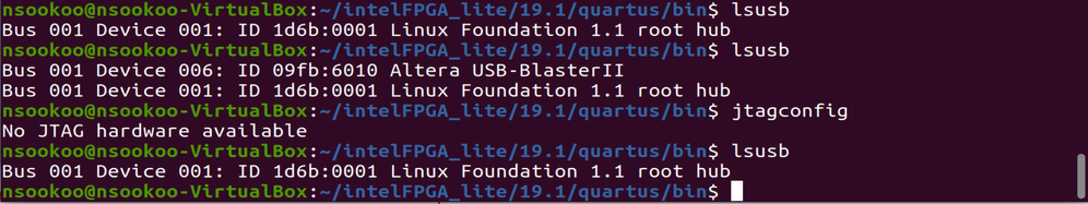

    When I initially typed lsusb. it initially showed that the USB-Blaster was connected. When I typed jtagconfig, the blue light on the USB-Blaster turned off and then on again. Not sure if my USB-Blaster is working properly as I saw yesterday that after a while, it was disconnected from the USB bus. When I remove and reinsert the cable, it appears in the bus again.

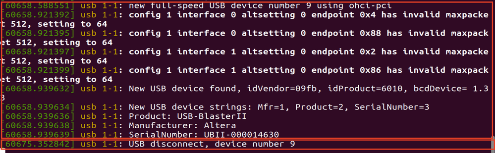

    This is the output when I run dmesg -w. The first box indicates when the device is initially connected. The second box is the output when jtagconfig is run. Not sure why it is disconnecting.
