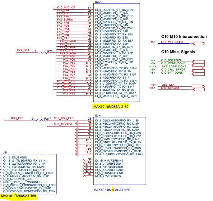

7 years agoHow do I report an error in Intel's document 150-0321321-A1 "Cyclone 10 LP FPGA Evaluation Kit Board"?
Part U3H is labeled MAX10 10M108SA U169, but it should have been MAX10 10M08SA U169 without the 1 between 10M and 08SA.
1 Reply
- AnandRaj_S_Intel
Thanks for bringing it to our attention.
Yes, We can see the typo mistake.We will report it on your behalf and get back on this with updated schematic.
