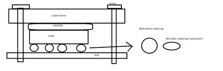

6 years agoHi, What are the tolerances for the 5AGXMB7G4F35C5N BGA package or where can i find them? Especially the height tolerances including the BGA are needed.
I would like to connect the mentioned FPGA via a gappad to a cooling frame. The FPGA is so to speak "pressed" to the frame. The force is brought by many srews. Therefor the compression of the gappad ...

6 years agoHi SUrba3,
Thank you for contacting Intel Community.
Please refer to Packaging specification and dimension page for the device package dimension.
https://www.intel.com/content/www/us/en/programmable/support/literature/lit-index/lit-pkg/package.html?family=Arria_V
