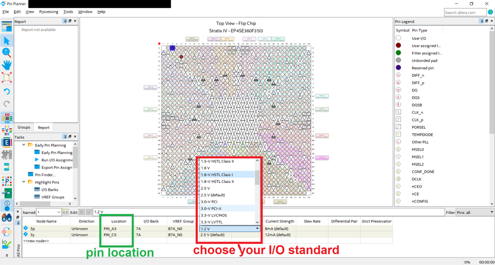

    You can use Assignment Editor or Pin Planner to assign FPGA pin in Quartus.
    Go to Quartus>Assignments>Assignment Editor/Pin Planner
    In Assignment Editor or Pin Planner, you can assign pin location, I/O standard, Current strength and etc.
    Below is example how Pin Planner looks like:
