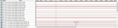

Hi , I am working with DE10-nano board to access external DDR3. FPGA-to-HPS SDRAM Interface- AXI3 is not working properly(axi_awready is always low)

The waitrequest is a mechanism for throttling the source of traffic to the IO Slave port. If the waitrequest is asserted High (or in other word axi_awready is always low) , it means the IO slave port does not have enough resources to keep accepting the write burst. It requests some time to wait for data processing. So, may I know for how long is the waitrequest remain high ? Is it too long ?

Thank you so much for your assistance . Finally It worked😃 . The second link you have mentioned solved the problem.
