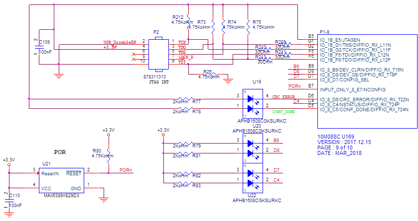

7 years agoHello I AM BULIDING A SCHEME WITH INTEL MAX 10 , AND I WANT TO CONNECT THE JTAG IN THE NEXT CONSTELATION , Is it ok ?

Hi LBelo1,
TCK pin should connected to 1kOhm pull-down resistor
and, I recommend to leave TDO pin unconnected if not used.
Please refer to MAX 10 pin connection guideline for more details:
https://www.intel.com/content/dam/www/programmable/us/en/pdfs/literature/dp/max-10/pcg-01018.pdf

Thank you very but,
is everything else is ok ?

And for TDI pin, you need to pull-up to 10kOhm. (you are pull-down the TDI pin)
TDI & TMS = pull-up
TCK = Pull-down
TDO = leave unconnected or pull-up
