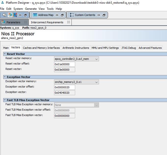

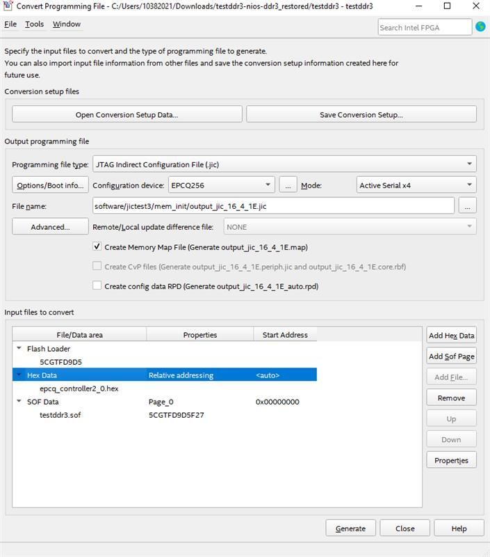

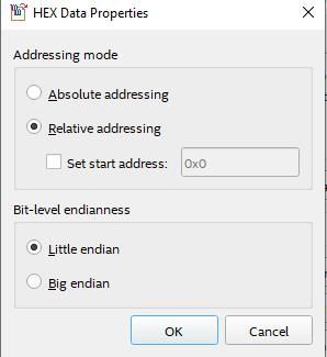

FW_CODE_NOT_WORKING_WHEN_CONFIGURED_FPGA_WITH_JIC_PROGRAMMING
Hi Team, We tried to check the jic file programming setup in Cyclone v gt eval board. For that we have created the system in FPGA design like this: nios ii reset and exception vector param...
