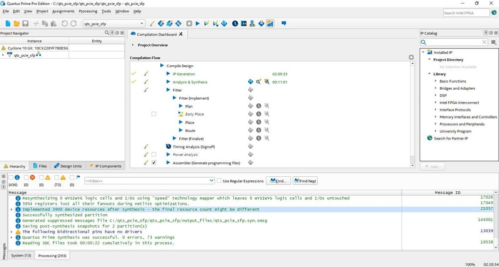

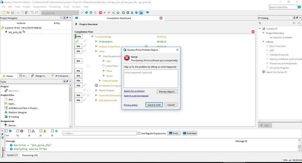

  • AnandRaj_S_Intel's avatar
    AnandRaj_S_Intel
    The error is due to directory path length by having smaller working directory / path length we can solve it.
    Anand
