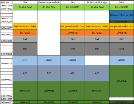

Hi I'm working on CycloneVsoc Dev Kit baremetal system Now I want to use F2H sdram to transmit my data. The draft system Interconnection: HPS host master | | host order | SelfIP...

I think you can use the same software code from this design example as reference to perform the transfer for your baremetal application:
https://community.intel.com/t5/FPGA-Wiki/MSGDMA-design-example/ta-p/735335
The sdram is refering to the external sdram which is the DDR for your case.
If checking that specific start address for your baremetal application which loaded to the DDR, you can see the same application content which you have built.
