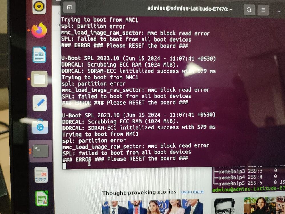

Dear sir/madam,
I am working on cyclone v 5CSEBA4U2317 SOM with custom board. I am using U-boot -socfpga-socfpga_v2023.10 and linux-socfpga-socfpga-6.1.68-lts files for generating u-boot-with-spl.sfp ,zImage and DTB file in ubuntu 20.4. I had created the image file using 3 partitions(fat,ext4 and a2 type) to boot the SOM. I had loaded the file system in ext4, u-boot-with-spl.sfp in a2 type partition and zimage and devicetree in fat format. I had placed the sd-card in board. I had get the following error.
I had followed the below link to generate boot files.
https://github.com/zangman/de10-nano

    Back to your issue, have you verified the SD Card is working? Because from the logs there are error in reading the SD Card.
    I would suggest you try the uboot build flow in the link below:
    https://www.rocketboards.org/foswiki/Documentation/BuildingBootloaderCycloneVAndArria10#Cyclone_V_SoC_45_Boot_from_SD_Card
