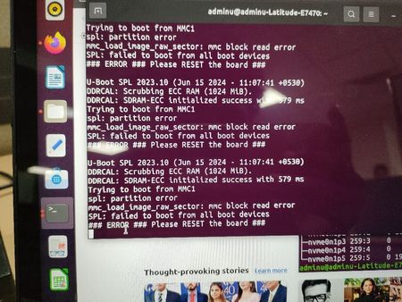

Error in u-boot.

Back to your issue, have you verified the SD Card is working? Because from the logs there are error in reading the SD Card.
I would suggest you try the uboot build flow in the link below:
