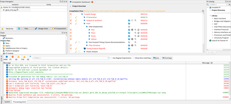

Error 16045: Instance "auto_fab_0|alt_sld_fab_0" instantiated undefined entity

The same issue is shown after I disabled the signal tap in Assignments -> Settings -> Signal Tap Logic Analyzer and removed the stp file in the qsf file.
Even I tried to download and compile a clean version of GHRD from (https://rocketboards.org/foswiki/Documentation/Stratix10SoCGSRD), then follow the project build instructions:
make clean && make scrub_clean && rm -rf output_files make sof
same issue happened in the terminal (see attachment snapshot).
This thread (https://www.intel.com/content/www/us/en/programmable/support/support-resources/knowledge-base/tools/2017/why-does-quartus-give-a-instantiates-undefined-entity-error-when.html ) showed the similar error message. However, it asks me to contact Intel support.
I am compiling the design on our Linux server and this issue suddenly showed up starting this week. When I compare the working syn.rpt and problematic one, I saw difference in the "Synthesis Source Files Read" section (see 2nd snapshot). The working one (right) listed *alt_sld_fab* files as Encrypted Megafunction, while the non-working one (left) showed those files are not Encrypted. Is this the reason that Quartu failed to locate those files later in the report?
If there is other solutions I can try, please let me know. Thanks for all the help.

Seems the snapshot in the previous reply does not work, re-pose them here. See attachment.
