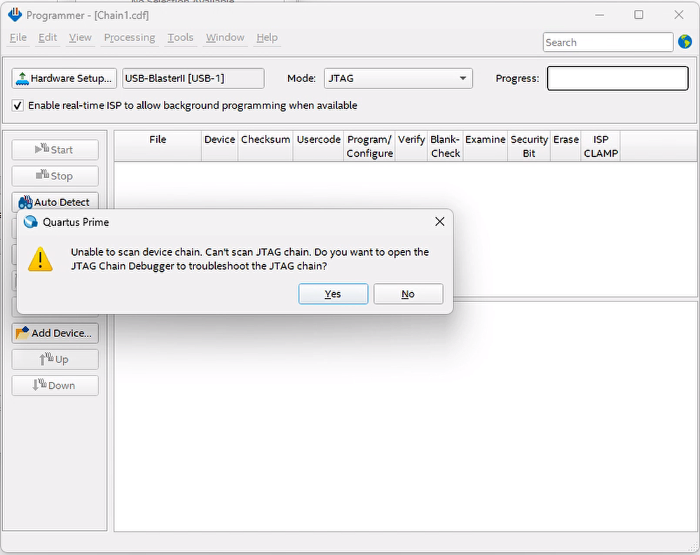

I get a DK-DEV-AGI027R1BES board, and jtag chain broken after pcie test, I try to fix it by following following post, but I don't have max10_bmc_avstx8_test.sof, can anyone send me a copy? or tell me where I can download it?

    detailed description here.
    I get a  DK-DEV-AGI027R1BES with no installer package.
    JTAG chain is broken when configure FPGA with pcie ed test.

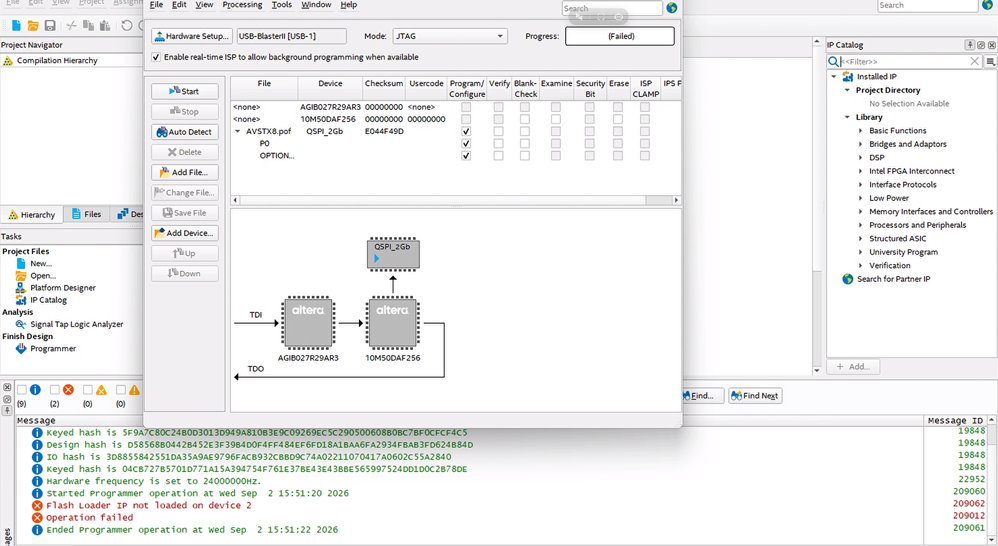

    Tried recovery with files in installer package in DK-DEV-AGI027-RA-B, but failed with Flash loader IP not loaded.
    most likely the files of R1BES and production are different, and in production installer package, this is no max10_bmc_avstx8_test.sof.
    Can anyone send me the board files for DK-DEV-AGI027R1BES?
