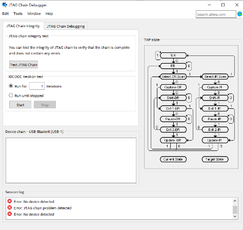

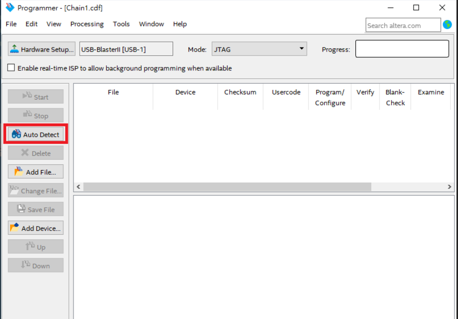

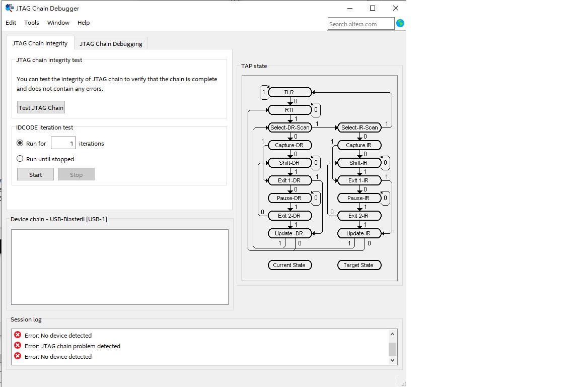

DK-DEV-10CX220-A shows JTAG can't find the chip, how do we solve it?

    Can you put what you see in the quartus programmer screen shot here?

      -Development environment, Windows 10? Intel software name? Revision?
      1、windows 10 Quartus (Quartus Prime 20.1) Lite Edition
      -Follow by xxxxx user manual to start using this board, and got stuck on step# ?
      2、first step no work
      -Software shows it can’t connect to the main chip xxx and screenshot for reference.
      3、already provide
      -Also provide LED status of development board, red/green or other LEDs might help to debug at the same time.
      4、D15、D16 Green

    We connect to micro usb, it suppose to show USB Blaster II, but there's no response.
    also download official testing program and it can't locate FPGA as well.
