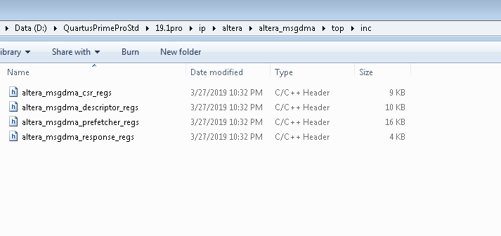

- MEIYAN_L_Intel
I have verify the location and the picture attached below shown the path of the files located.
- AJung123
Ah, ok. I am using a Linux machine, so the path was slightly different. I was able to locate the files now. As a follow up, I was wondering do the HAL drivers only work when the platform designer includes the Nios II processor or can they function if only the HPS is connected?
