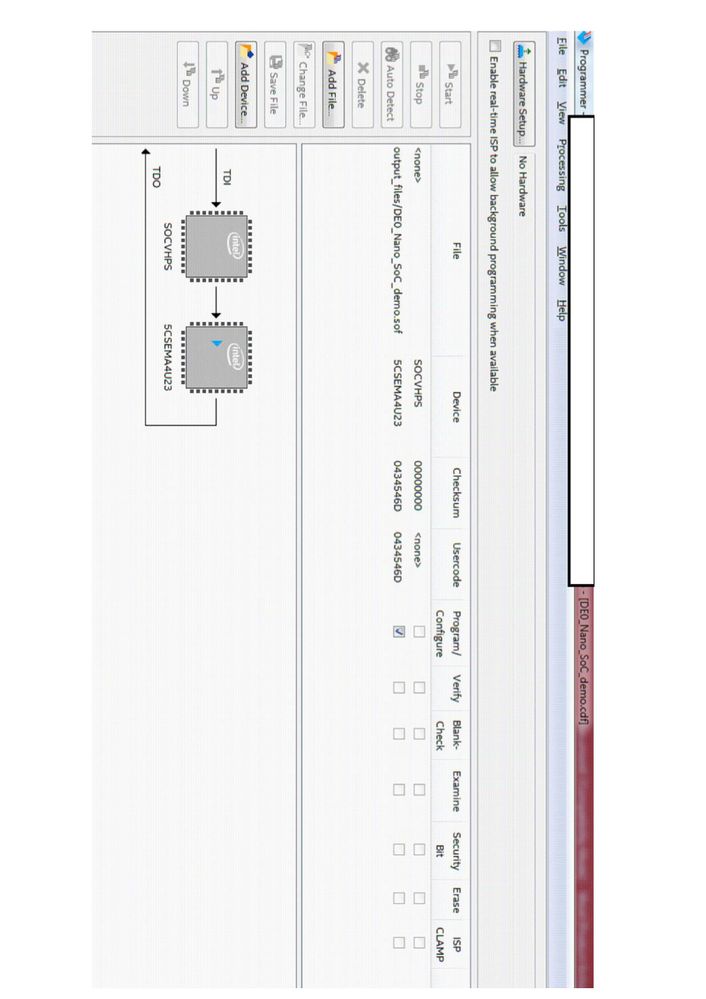

  • DKirv's avatar
    DKirv
    It appears to be a .sof file that is loaded. See Image. I am in JTAG mode.

    • EBERLAZARE_I_Intel's avatar
      EBERLAZARE_I_Intel
      Did you previously flash the board before programming the board with the .sof? You may need to erase the flash so it does not have previous programming file on it that may have interfere with the board. I am suspecting this is the case.
