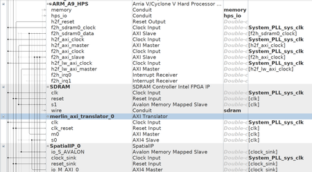

DE1SoC (Cyclone 5), SDRAM sharing between HPS and FPGA
I figured it out myself. It seems to be the case that on DE1SoC, when u-booting, one needs to enable the fpga2sdram_handoff and bridge_enable_handoff in order instruct the HPS to enable SDRAM bridge connections. I'm not sure if this is documented anywhere in the qsys / quartus manuals.
- EBERLAZARE_I_Intel6 years ago
We recommend that you check out rocketboards.org (and select "START") for recommended booting steps and for this case, a u-boot script usually handles the bridge enables, you may refer here on how to get the u-boot script:
https://rocketboards.org/foswiki/Documentation/AVGSRDSdCard
You may also refer to:
https://www.intel.com/content/www/us/en/programmable/support/support-resources/knowledge-base/embedded/2016/how-and-when-can-i-enable-the-fpga2sdram-bridge-on-cyclone-v-soc.html
