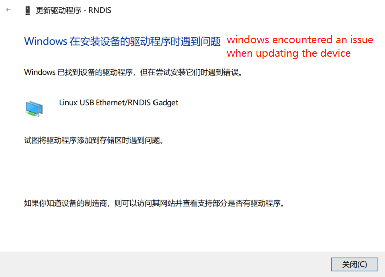

Hi, I 've just got another issue:

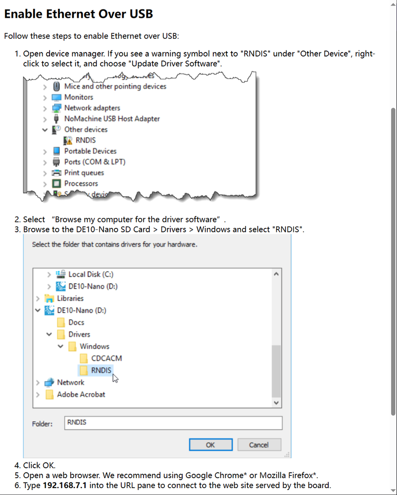

now that I could finish #2, Booting the board, I am goning to test #3, Interacting with the board. I found the START.HTML from intel github: intel/de10-nano-drivers (github.com) and the instruction is as follows:
However, after connecting the board with my laptop and update RNDIS, my laptop showed :
although the RNDIS icon has no yellow triangle: , I could not visit 192.168.7.1 shown in step 6 in START.HTML.
I am new to this board and I don't know if this step is necessary or if I can just skip it.
- tehjingy_Altera
Hi
That step is really not so necessary, it is enabling the Ethernet over USB.
If you are able to get the linux console from the uart terminal that should be sufficient. (Section 5.1 in the link below)
