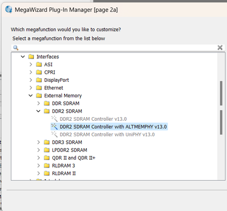

"Q1 : I used MegaWizard Plug-In Manager to create a DDR2 Controller (as shown below). Do I need to pay for the use of this IP?"
- No. The Quartus II Web Edition no longer require a license file.
"Q2: Can the purpose of creating this IP be understood as the communication interface between FPGA and external DDR2?"
- Yes
"Q3 : The following picture shows the instantiated DDR2 IP. Is the subsequent control for data transmission and storage primarily handled by ddr2_ip_example_driver (without modifying ddr2_ip_inst)?"
- Yes. It's an example design that generated to test the IP.
