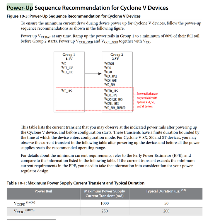

We are powering the device up in the reverse order of what Intel recommends. However, the documentation just states the device may draw more power then expected at power on. The FPGA and SOC are basically powered on at the same time with the core for both powering up last.

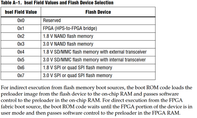

- BSEL[2:0] = 111, The Boot Select pins are setup to boot from QSPI NOR and appear to be up and stable before POR. The HPS boots and then loads the FPGA.

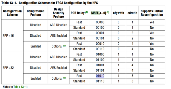

- MSEL[4:0} value of 01010, Fast Power On

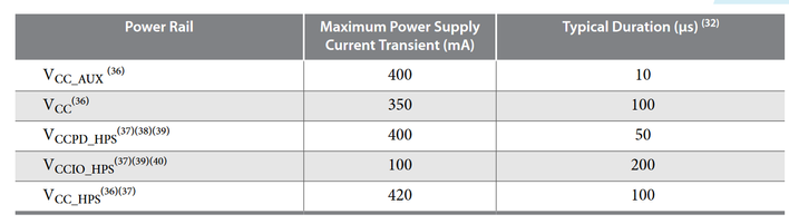

- Cyclone V Device Handbook indicates that you can power up the device in any order, and then gives you a table listing current transients at power on if you do not follow the recommended power up sequence.
