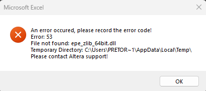

Corrupted Early Power Estimator (EPE) for Cyclone V (epe_zlib_64bit.dll not found)
I downloaded Cyclone V Early Power Estimator using the following link: Early Power Estimators (EPE) and Power Analyzer | Altera
It seems the provided Excel file is corrupted. Even though I followed the instructions under "Known issues for Early Power Estimator (EPE) tools" and the following discussion (Cyclone V Early Power Estimator not opening - Intel Community), I am not able to run the macro. For this reason, I created a new post.
My colleagues also have the same issue. All of us have Windows 11 OS and the latest version of Microsoft Excel. Even our IT department could not solve the issue in case there was a problem regarding Microsoft.
I attached the screenshot for the error that I got. (epe_zlib_64bit.dll not found)

    Thank you for your response. I followed the steps that you provided once more and unfortunately it did not work. We use Microsoft 365 and Windows 11 OS. Unfortunately, none of my colleagues are able to run the macro due to same environment. Until a month back, we were able to run it, now we are not.

    I followed the instruction that you suggested. Unfortunately, I still get the same error.
    It seems it is possible to run the macro on a PC W11 23H2 but not on a PC W11 24H2. Since we all have PC W11 24H2, we still have this issue.

    I also encountered the same issue on Windows 11 24H2, Excel Version 2507 Build 19029.20184.
    I recalled that EPE was working earlier this year, so I thought rolling back Excel might resolve this issue and tried it—and it actually worked.
    I used the link How to revert to an earlier version of Office and rolled back to Excel Version 2501 Build 18429.20132.
    While this doesn't provide a fundamental solution to the issue of it not working in the latest version of Excel, given Intel's lack of enthusiasm for fixing the EPE vulnerability, I believe this method is currently the most straightforward option.

    I was able to get the EPE to work finally on my Windows 11 PC running Office 365. When I first opened the EPE, it created the epe_zlib_64bit.dll file in the same directory as the EPE, but that still did not enable the macros in the EPE. I made copies of the epe_zlib_64bit.dll file in these folders:
    • c:\Windows\System32
    • c:\Windows\SysWOW64
    I closed all instances of Excel, opened the EPE, and the macros worked fine.
