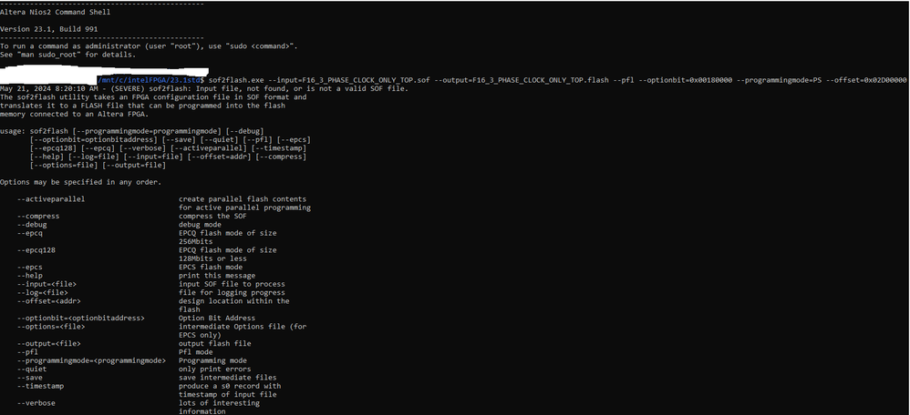

Converting .sof to .flash in Nios II Command Shell
I've got an Arria 10 GX FPGA Development Board (DK-DEV-10AX115S-A) and am trying to convert a .sof file to a .flash file for use with the board. I'm using Quartus Prime Standard 23.1.

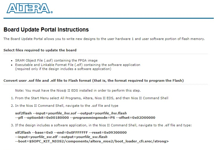

I'm referring to these instructions to attempt to do that:

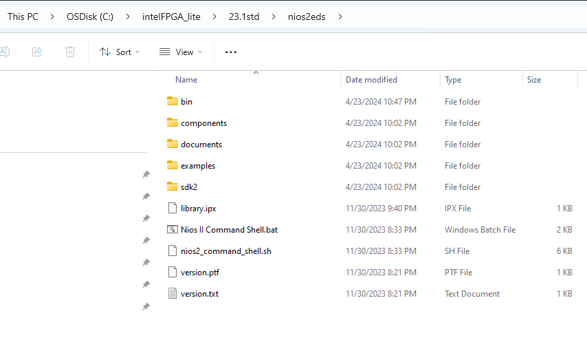

Step 2 instructs to navigate to the .sof file while in the Nios II Command Shell. How is this done?

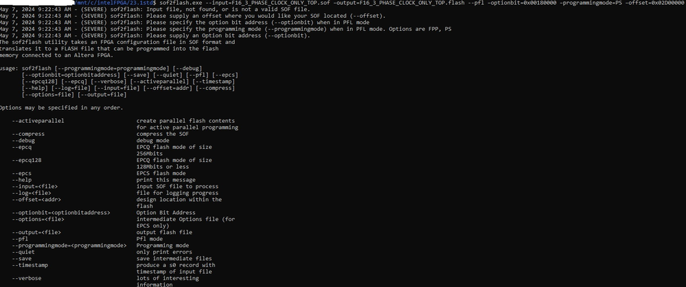

Without navigating, I've entered the Step 2 text but received this message when completed:
No .flash file appears to have been created.
How can I create a .flash file?
