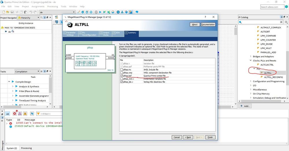

    1. I can understand your confusion about the megafunction, please refer the below screenshot & invoke it from IP Catalog.
    2. You should use the verilog since it is mentioned in user manual.
    please let me know if you have any different concern.
