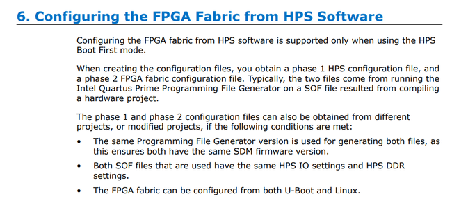

I follow the 6.2 chapter of "ug-agilex-soc-boot-683389-766161.pdf" file to configure the fpga fabric from linux. But the error is occurred:
I don't know what happened. Please help!
The following message should be told to you:
1. Quartus Prime version: 22.4;
2. Linux kernel version: 5.15.70;
3. Soc fpga type: Agilex7;
4. Match to below requirements:
