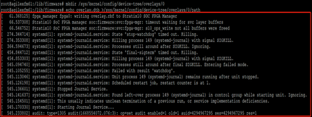

I follow the 6.2 chapter of "ug-agilex-soc-boot-683389-766161.pdf" file to configure the fpga fabric from linux. But the error is occurred: I don't know what happened. Please help! The follow...

May I know are you working with a gsrd?
You can try to get the gsrd first to boot with prebuilt binaries in order to check without issue and also as a reference to troubleshoot any issue when building your own images.
Then by following the building bootloader document to modify/build part of the binaries to test out for any issue comparing with the prebuilt binaries.
