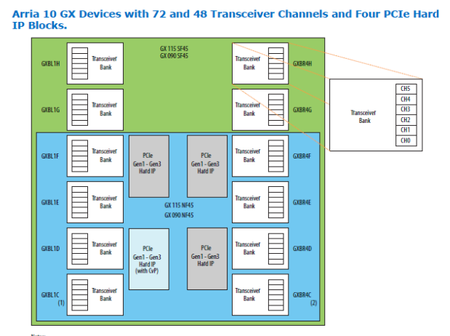

I am interested in using the Arria10 GX Dev Kit and using the PCIe Hard Macros in them. I have managed to create a PCIe Hard IP in a QSys project but I can't seem to understand how to constr...

Hi Prateek,
The software will issue Fitter error messages if you select the wrong pin. The compilation will stop at Fitter stage.

Yup, that worked out. I tried changing some settings in the pin planner and the error appeared in the fitter stage.
